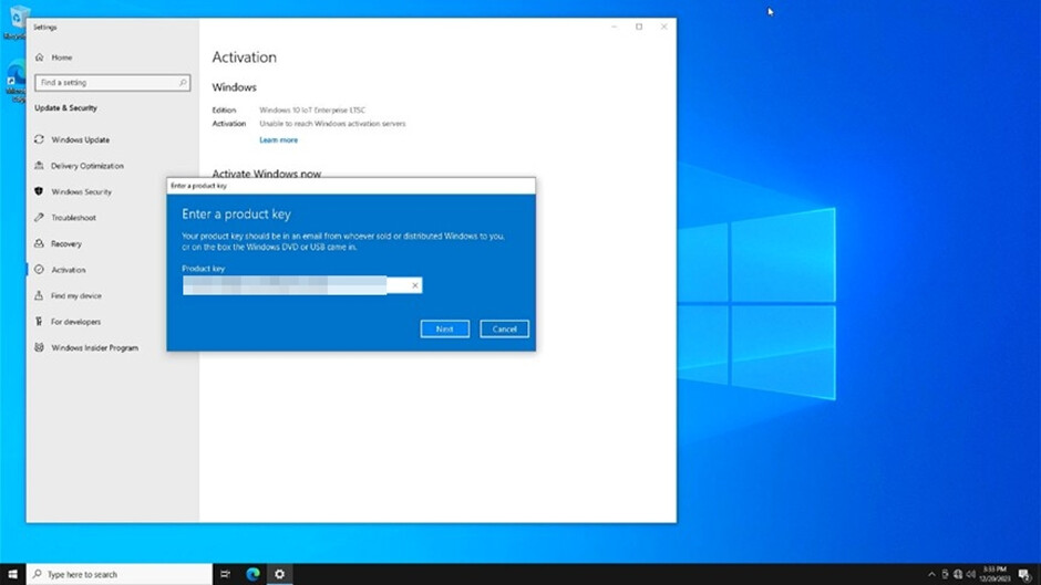

4. Activating Windows 10 IoT Enterprise
4-1 Open the Windows Settings page.
4-2 We need to activate Windows 10 IoT enterprise on EPC-R3720. Please select “Change Product Key”.
4-3 Type your product key, and make sure you are connected to a network.
Note: The product key is on the license label as shown.
4-4 Click “Next”.
4-5 Click “Activate”.
Wait for about 1 minute.
4-6 Receive confirmation that Windows 10 IoT Enterprise is activated.
