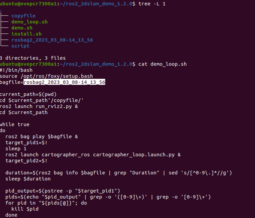

SLAM demos
Download ROS2_2dSlam_Demo package to the system.
Copy the ROS2_2D_SLAM_demo and place under /home/Ubuntu
$ cd ~
$ tar zxvf ros2_2dslam_demo_1.2.0.tar.gz
- Run Install.
$ cd ros2_2dslam_demo_1.2.0
$ sudo chmod a+x install.sh demo_loop.sh
$ sudo ./install.sh(PW: ubuntu)
- Run 2D SLAM demo.
$ ./demo_loop.sh
Demo video:
Screencast 2023-09-18 01_59_12.mp4
It can modify demo_loop.sh file “bagfile=rosbag2_2023_03_08-14_13_56” parameter to others rosbag2 file.
