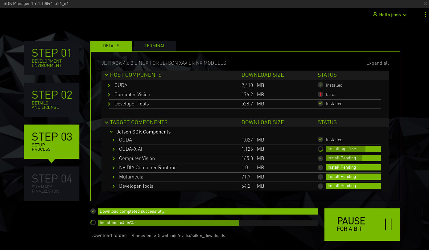

You can reference the link below to install Jetson Software with SDK Manager:
https://docs.nvidia.com/sdk-manager/install-with-sdkm-jetson/index.html
The OS image we have provided R32.7.1(DIV0003). It seems you have flashed to eMMC so please uncheck the Jetson OS when installing the SDK component.
Or can reference the Advantech wiki to install the SDK component.
Ubuntu L4T User Guide - ESS-WIKI (advantech.com.tw)

There was a problem with the apt not coming through in the SDK manager, which is being resolved.
Unable to connect to Jetson module using SDK Manager.
I have confirmed that it is detected on the host PC side with lsusb and with the SDK manager.

Hello,
Recovery mode is used for flashing OS image so you cannot ping the target devices successfully in recovery mode. It can only be used to flash OS image to the target in recovery mode. After the OS image has been flashed to the target, then you can use the Micro USB port (l4tbr0 IP Addr: 192.168.55.1) to install Jetson SDK components. Check the IP Addr in the target ubuntu OS. The IP Addr is 192.168.55.1 in “l4tbr0”
So,
  1. Please make sure that your target device (Xavier NX) has flashed the OS image.
  2. Power on the Xavier NX system and connect the micro-USB cable to your Ubuntu host system (Type A)
  3. Now it can ping 192.168.55.1. The default USB IP address is 192.168.55.1.
