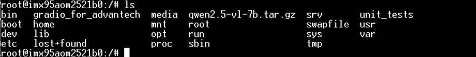

5.2 Stage the model weights
Place the model archive at /root/ on the board. Do not extract it — extraction is handled automatically by the demo’s post-install step:
scp qwen2.5-vl-7b.tar.gz root@<board-ip>:/root/
Figure 5 — qwen2.5-vl-7b.tar.gz present on the filesystem.
Figure 6 — Verifying the archive is in /root/ before installing the demo.

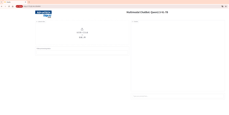

On the host PC, open a browser and go to http://<board-ip>:8081/:
Figure 10 — The Gradio UI: upload panel on the left, chatbot on the right.

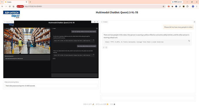

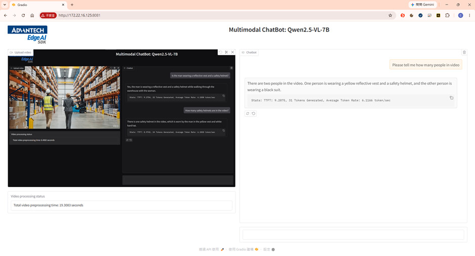

Upload an 8-second clip and wait for pre-processing to finish:
Figure 11 — Video pre-processing in progress.
Figure 12 — Pre-processing complete (“Total video preprocessing time: 19.3083 seconds”).
Type your question in the chat bar and submit. The VLM answers with per-response stats (TTFT, tokens generated, token rate):
Figure 13 — Q&A on a warehouse clip: the model counts people and describes what they are wearing.
